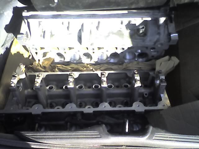

3 sets of ported heads and a pair of 5.4L blocks gave me parts to build from
and parts to use for all the mockup work for new parts designs. I would have been
happy with any one of the block/head combos but the extra bits made the ideal pairings
much easier to come by. I added a nice set of Comp cams to make the heads worth it
and we are off to the races.
